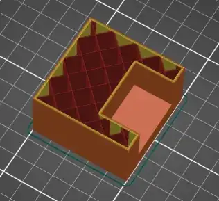

I'm using PrusaSlicer with OpenSCAD. I want to print a solid object with a notch in it, without top layers, but with infill and solid walls for the notch, like this...
Screenshot of the preview of a 3D model in PrusaSlicer

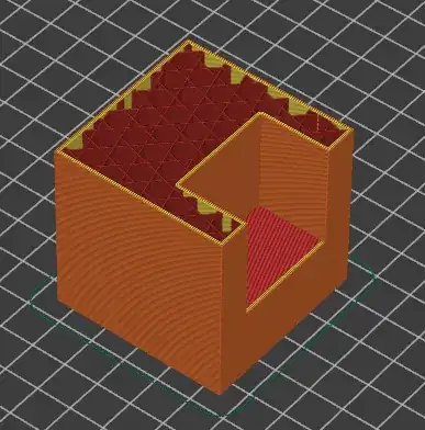

I can set the number of top layers to zero (Print Settings > Layers and perimeters > Solid Layers > Top = 0), which gets rid of the top layers as desired, but it also removes the base from the notch, like this...
Screenshot of the preview of a 3D model in PrusaSlicer with no Top Layers

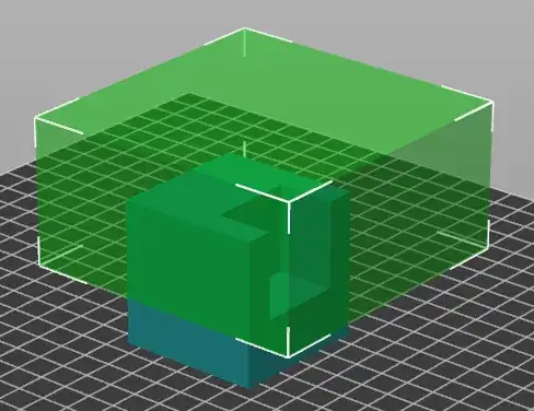

First load the cube with notch, and then load/insert a modifier to get something like the following (grey is the box with notch, green cube is the modifier):

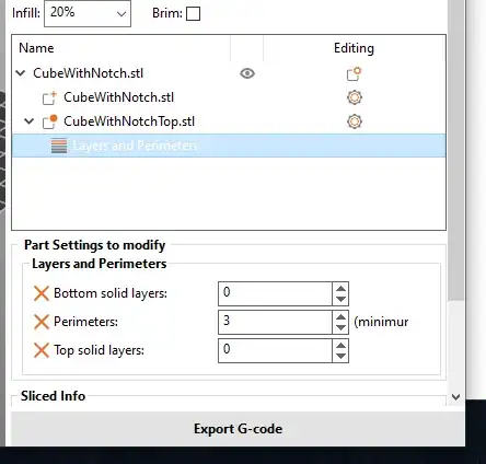

Now change the options (click on modifier and left-click to select Layers and Perimeters option item) of the modifier (select zero top and bottom layers): enter image description here
The sliced solution will look like what you request: enter image description here
Note that this solution will give you an object that is exactly the height of the designed cube, it just doesn't have a top surface, but infill and walls to the top.
