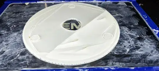

Instead now I'm facing another problem. After "some" (few or even after 10h) suddenly the filament does not stick anymore to the previous layers.
Here an example:
As you can see it completed the rafting very good (not sure if there also some few layer of the object) but then the new layer did not adhere and I had to stop the printing.

What can be the reason for such a failure?
UPDATE
I had better results (not perfect, though) increasing the temperature to 245 °C and reducing the air gap between raft and object to 0.1 mm.
