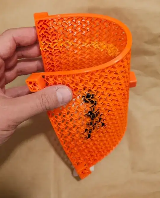

I have tried to use PETG grid to hold my ABS models above the acetone for vapor smoothing. Specifically, I have used Prusament PETG in the Prusa Orange colors.
After a few hours acetone turned orange, and grid turned soft and gooey. Can't tell if all PETG will be affected, but this one sure is.
Element below was flat and stiff. Photo of the crate
