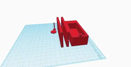

I designed a puzzle box in Tinkercad. Here are some images of the design:
Screenshot of puzzle box designed in Tinkercad

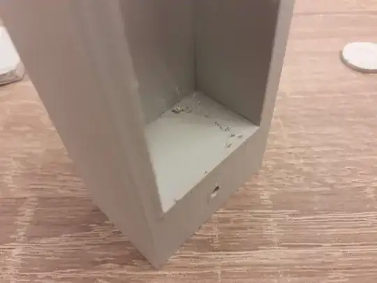

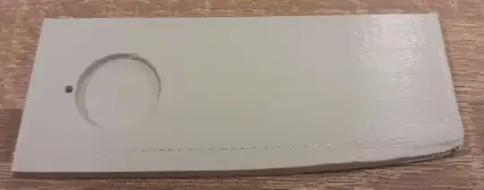

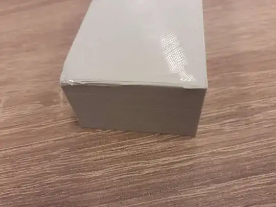

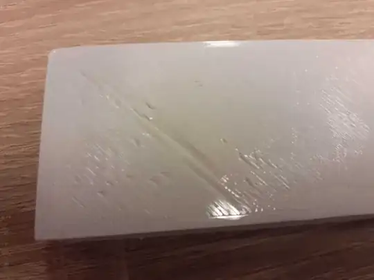

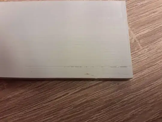

Print 1
This print actually came out pretty ok, but not the quality I'm looking for.
Photo 1 of a printed model #1 with printing errors on bottom layer
Photo 2 of a printed model #1 with printing errors on bottom layer
Photo 3 of a printed model #1 with printing errors on bottom layer

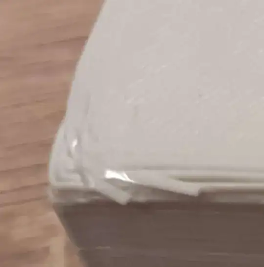

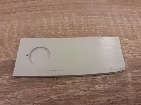

Print 2
For some reason, this one came out way worse in my opinion. I didn't change any settings. The reason why I made this second print is that there are some design flaws in the first print.
Photo 1 of a printed model #2 with printing errors
Photo 2 of a printed model #2 with printing errors
As you might be able to tell, this one has some more severe problems, like the prolapse on one of the corners of the lid and some threads that just seem to be broken off here and there.

There are several issues at hand here, first you have an adhesion problem.
This print shows that the print (as it is printed upright) has come loose during printing and lifted up. Such a print should have been printed as it is now laying on your table. You will then also get far better quality of printed holes. So, second is print orientation on the build plate.
This shows another example of adhesion problems, but it also shows that you initial distance between the nozzle and the bed is slightly too large. The paper method usually works fine, but you can use feeler gauges. Alternatively use a specific 3D print adhesion spray (3DLAC, Magigoo, DimaFix) or alternatively some hairsprays or glue sticks.
Third, design. Just a tip, I see that your design uses some sort of a pin:
you should avoid thin pole/spike like prints. These are difficult to print and usually very weak. Think of an alternative, an embedded shaft or a bolt is usually a much better solution.
Fourth, this shows that there was no filament printed, it could be that the spool had extra resistance or the filament was entangled. Check your filament spool.
Fifth, this shows that you have a retraction problem, the filament pressure is still too large when the head moves to the next coordinates, it then oozes until the pressure has been released. Changing retraction speed or distance may help.

Also, that large lid should be printed laying flat on its back. Even the action of the bed moving around could be creating enough breeze to cool that part quickly and cause shrinkage.

Holes in a printed part are a kind of under-extrusion, and mean there's not enough plastic at that time. If your roll of filament is under friction then the printer may not be able to pull it in fast enough.
Also if the hotend isn't hot enough it may not be melting quick enough for your print speed, or there may be clogs in the nozzle from contaminations in the filament.
