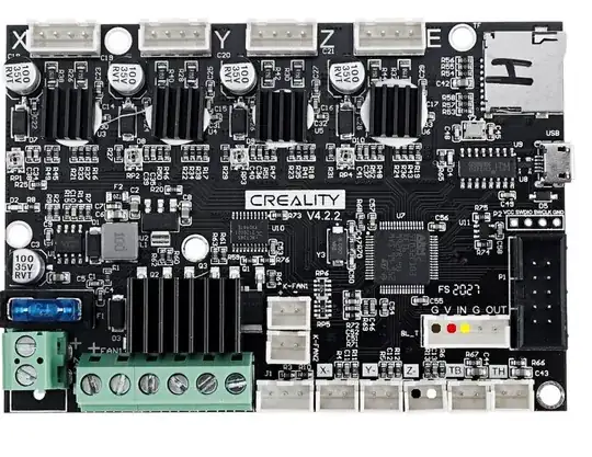

and that connector is supported on the board that seems to be shipping with Ender 3s these days, the Creality 4.2.2 board (Notice it's in the bottom right and says BL_T next to it)
Creality 4.2.2 Board

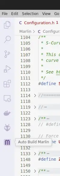

  4. Now we need Visual Studio Code (told you you get to be a developer). Once you open it, you'll need to install an extension Marlin made for VSCode to allow you to easily build your firmware. The instructions on installing Auto Build Marlin.
  5. Now you have a neat little button in VSCode to do stuff with Marlin.
    Auto Build Marlin in VSCode
    But wait! We're not ready to click that yet. First we need to modify those configuration files you downloaded.

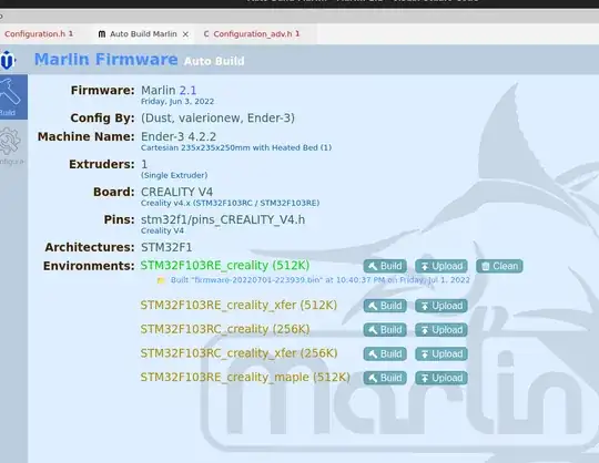

  7. Finally, you're ready to build. Click on the "Auto Marlin Build" extension, then click "Show ABM Panel".
    Show ABM Panel Button
    Marlin should have figured out that you're trying to build for an Ender 3. I honestly don't know what the different environments are for, but the first one seems to work just fine.
    Marlin Builds
  8. Once the build completes, there will be a link which will open the folder where the build is. You'll want to get the SD card from your Ender 3 and copy the .bin file from that folder onto the root of the SD card. Then stick the SD card in your Ender 3 and power it up and you should see your new Marlin Firmware start up. Then you can start configuring your BLTouch for auto bed leveling.
