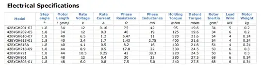

I would like to replace a NEMA 17 stepper motor for my FLSun SR (it clicks and the rotor eventually slides forward, causing it to offset layers). How do I find the specs for this motor? They aren't listed on FLSun's website and I tried their contact us form. The back of the motor has this written on it:
FLSUN STEP MOTOR
42BYGH718-B-28Q
LOT NO.210711
The total length of the motor is 47 mm.

As mentioned in the comments by Mick. The full datasheet can be found on promoco-motors.com. Below is a table with electrical specifications from the mentioned datasheet.
electrical specifications of 42BYGH stepper motor
