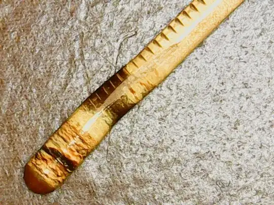

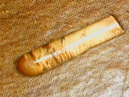

Examples of what the filament end looked like when a clog formed:
filament1
filament4
Since the melted material is so short I don't think it's heat-creep. Maybe it's the (very cheap) nozzles themselves having inconsistent dimensions? Not being able to retract a few mm and re-extrude by hand seems pretty odd. I have ordered official E3D nozzles to try in case they are the culprit.
Any thoughts on what else it could be?
