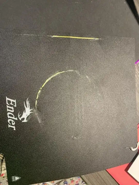

I'm having a lot of issues leveling my printer and one failed print came out like this. Is there something wrong with the surface that I need a new bed? This happens to me quite often and I literally can't get it off.

Print the print once more. the first few layers will adhere to the excess material and you can then peel it all off.

If it's flat so you cannot scrape it off you can just print over it. No need for a new bed.
Check your levelling first because if it's sinking into the bed then the nozzle is far too low and you can end up with a scenario where it rips the bed material when you remove a print.
