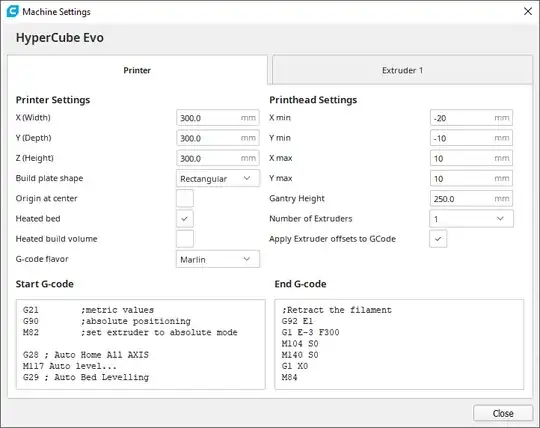

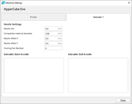

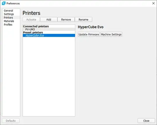

The nozzle diameter is part of the printer configuration, but, linked to the Line Width property. You therefor can set the line width to 1 mm to achieve the same. With respect to the nozzle diameter, it is also found for the custom printer layout using the following: with reference to version 4.13.0, the nozzle diameter is set in the machine setup. From the main menu go to Settings->Printer->Manage Printers.... Now select your printer (and activate it to be able to) select Machine Settings and go to the extruder tab sheet to change the nozzle diameter (option Nozzle size under nozzle settings).
Cura printer preferences window
Printer settings
Extruder settings

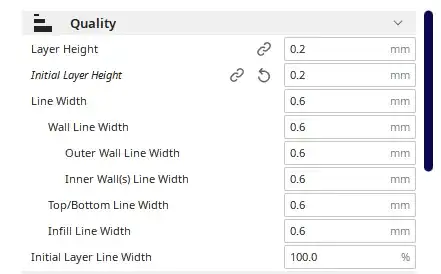

If you change the setting of the nozzle size you will see that this updates the option "Line Width" of the Quality group print settings to the same size. E.g. after changing the 0.4 mm nozzle value to 0.6 mm you will find the line width value updated:
Updated line width property

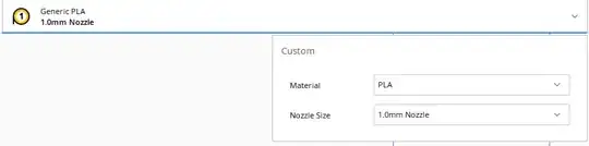

This is for Cura 4.13.1 but it shouldn't be very different than 4.11.0. This is also for the standard Ender 3 profile; it is not necessary to create a new profile for a different nozzle.
In the main window, select your filament then a drop-down window will appear with the Material and Nozzle Size. Select Nozzle Size and pick the desired size from the drop-down menu.

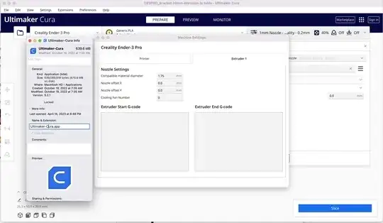

To confirm the OP's issue using Cura 5.2.1 and 5.3 (4/13/2023), as opposed to 4.x, I am attempting to change nozzle size on Ender 3 Pro and this is not in the following menu:
Manage Printers>Ender 3 Pro>Machine Settings>Extruder
You can see on the left, I am using Cura version 5.2.1 (Mac OS 12.6 Monterrey)
Cura version

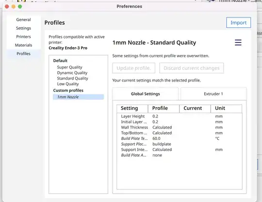

I was trying to create a profile for when I have the 1 mm Nozzle on there:
Preferences - Profiles dialog

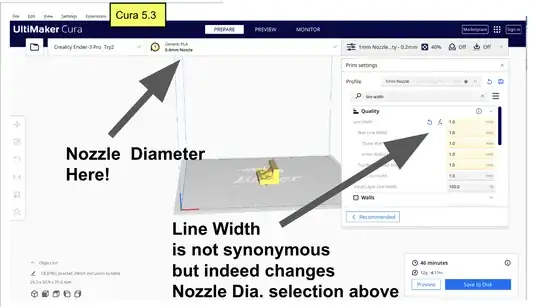

I was able to find Nozzle Diameter in a different place and change it successfully:
Nozzle diameter location
