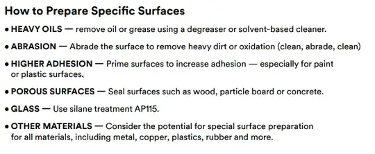

If you ook into the VHB design document, the section "How to Prepare Specific Surfaces" describes how to treat the surface:
For higher adhesion, a primer should be used according to the document.

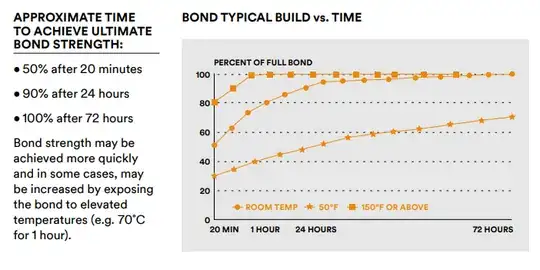

A higher temperature is beneficial for obtaining the bond strength faster, the VHB design document shows that increasing temperature shortens the time when the full bond strength is reached:
