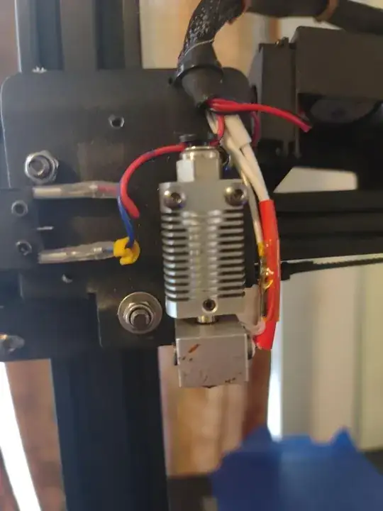

Does anyone know what hotend the Anycubic Mega Zero uses? I've found info on upgrading to a different one but I'm thinking of just buying more nozzles for now and trying other options later. I'm not sure if I'm looking at the right things when I did a Google search. The hotend I'm looking at looks like an MK8 or even a Mini Swiss but I've read it's a J-Head? Am I missing something?
Photo of the Anycubic Mega Zero hotend and extruder assembly

The picture you have shared leads me to believe that it is an MK10 style hot end (Sometimes erroneously referred to as a Creality-style hot end)
MK10 is identified by its 'Flattened' heat sink shape with screw holes through the heat sink for mounting, Along with the smooth, un-threaded geometry of the heat break entering into the heat sink.
MK8 is similar, Consisting of the same Flattened, screw-mount heat sink design. However, the MK8 hot ends use a threaded heat break on both sides, rather than only on the heater block side.
