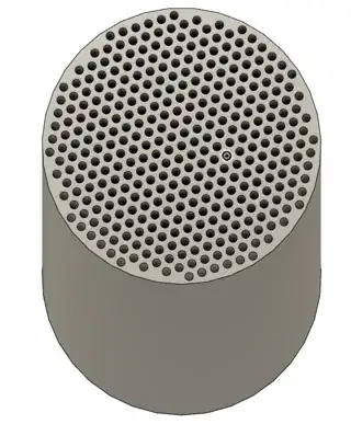

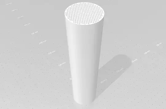

I'd like to print a cylinder, 50 mm diameter, 200 mm long, with 1.5 mm diameter holes tightly fit like this:
3D rendering of a cylinder with holes
The holes go all the way through from top to bottom.
I am using a Prusa i3 MK3S. With 0.1 mm detail and 20 % infill, printing one cylinder is going to take 5 days and 5 hours. I need at least five cylinders.
  • Is the above setting appropriate for this job?
  • Is there any way I can reduce the printing time?

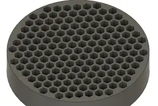

You are printing a model that has a highly complex structure there, with about 650ish holes, assuming there is space for about 2 perimeters between each hole.

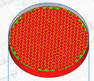

Taking my standard 0.3 mm layer height and 0.4 mm nozzle using a 0.45 mm wide line, I sliced a 10mm high slice of the model for a first estimate of the expected print time - and came out with 2:21 hours. That means the expected print time with 0.3 mm layer height is in the area of 47 hours - or just about 2 days.
As a result, 5 days and 5 hours are in the order I'd expect from a 0.1 mm layer height print for the same nozzle, in fact, your settings seem to have a faster print speed than I do work with.
In general, I don't think this model is good for FDM printing at all, due to many non-fully formed lines inside the model (yellow) and the red perimeters being a very dense pattern.
Sliced cross-section: in yellow: many extra thin lines!

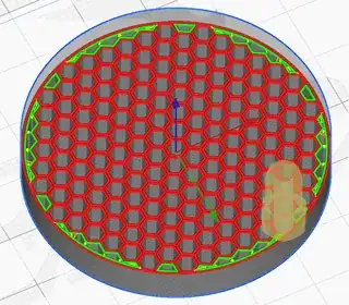

Another alternative would be to alter the pattern from a circle to a hexagonal pattern: by using hexagons, the resulting pattern does not contain thin walls and might print much faster - depending on hole size, you might experience a drop by a factor of 2!
