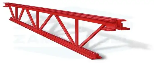

The zigzag is more rigid. You can push a square into a trapezoid without putting any of the sides in compression or tension. However, if you make a trapezoid with two triangles, the diagonal dividing the trapezoid. into squares resists an external force changing the shape of the trapezoid. Thus, the zigzag takes less material for adequate support than making squares as does cinder blocks.
Look at steel joist design.
