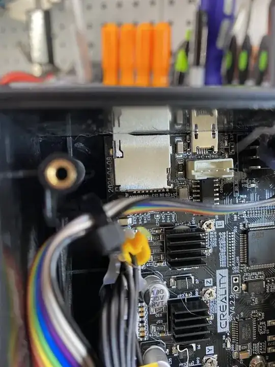

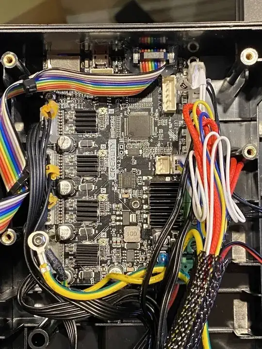

I have a new Creality Ender 2 Pro with a Creality 4.2.3 mainboard. I'm attempting to compile Marlin to fix a bug. How can I tell what driver chips I have on this board?
I've narrowed it down to likely A4988 or TMC2208_STANDALONE or possibly the TMC2225. Strangely Creality only has documentation for the 4.2.2 and the 4.2.7 boards (not 4.2.3)
4.2.2 => TMC2208
4.2.3 => ?
4.2.7 => TMC2225
Some say you can tell the driver just by listening to the noise it makes. Here is a video of the printer running. The motors are nearly silent to my ear.
Photo of Ender 2 Pro motherboard version 4.2.3
Top corner photo

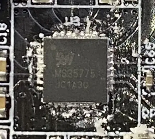

    After removing the heat sync, it appears that the Chip is actually a MS35775
    Closeup of MS35775 on board
Greenonline
  • 6,748
  • 40
  • 68
spuder
  • 221
  • 10
MS35775 appears to be TMC208 compatible. You can find the data sheet on relmon.com here is the overview:
  • 2-Phase stepping motor peak current of 2A
  • Step / dir interface 2, 4, 8, 16, or 32 microstep
  • Internal 256 micro steps
  • Quiet mode
  • Fast mode
  • HS Rdson 0.29 Ω ,LS Rdson 0.28 Ω
  • Voltage range 4.75 ~ 36V
  • When the motor is still, it will enter into the power saving mode automatically
  • Internal resistor mode is optional (no need for external sense resistor)
  • Single wire UART bus and OTP control
  • QFN28 package
