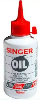

Personally I put a drop of light machine oil on the lead screw just above the Y gantry between prints, while the head is down. When it prints, the lead screw raises the gantry and the threads spread the oil.
If I was going to do a really tall print, I'd consider adding a little oil higher up the lead screw too where it rarely goes.
A Y axis lead screw is a low speed, low pressure and low temperature application, so anything "slippery" will do, but the dust repelling attribute is important.
Sewing Machine oil, or 3-in-1 oil would be ideal, as would a white lithium grease. You don't want a petroleum grease like in car wheel bearings because it attracts dust and is viscous/heavy, requiring more force to move around.
Singer brand sewing machine oil
Since your existing lead screw is "dry" a wipe with a clean rag should be enough to remove what was there. I would not use degreaser or solvent, and I would also avoid anything that is in a spray can/aerosol because you want to control where it goes, and avoid overspray.
Your nominated du pont lube looks fine too, though out of stock and it seems expensive.
