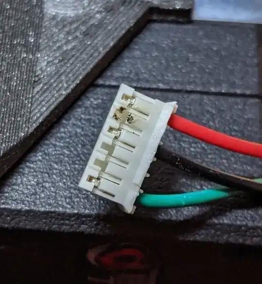

I'm struggling to find the name of a connector I just broke, so I can order a new one.
It's a six pin nylon terminal, that plugs into a set of header pins on a stepper motor.
What do I search for to find these?! Also, how would I go about finding something like this in the future? I seem to struggle to find connectors.

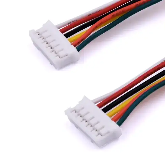

Without seeing the socket, it's hard to say for sure, however most Nema 17 stepper motors use 6 pin JST PH connectors with 2.0mm pitch on the motor side. Many control boards use JST XH connectors with 2.5mm pitch on the board side. The two are not compatible with each other due to a difference in pitch and the locking mechanism.
Looking at the sockets there is a clear visual difference: PH has a wide cutout while XH has two slots.
PH 6 pin socket PH vs XH XJ 6 pin socket
The difference on the plug side is more subtle. XH has small hooks that grab onto the slots while PH has not.

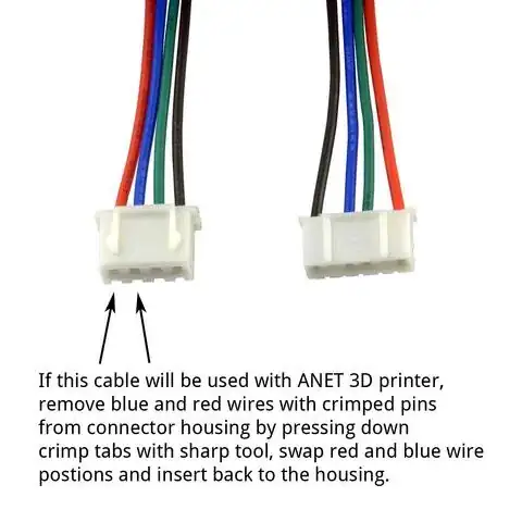

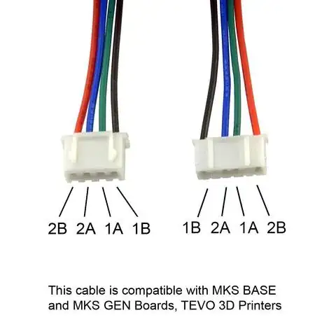

In an attempt to salvage my (sadly) previously incorrect answer (at the bottom), and to add to anttix's superlative answer, here is a quote from Stepper cable for MKS Boards pinout, which clearly shows the difference - locking and non-locking, and pitch difference (note the thickness of the plastic between each individual pin socket) - in the two plugs:
This pinout information will help you to use our 1 meter stepper cables correctly. Cable was made to be compatible with 6-pin JST connectors on NEMA 17 stepper on one side and 4-pin JST connector on other side. These cables are compatible with MKS BASE and MKS Gen boards that we sell in our store.
Female JST connectors for the control board (4 pin XH) and stepper motors (6 pin PH)
For compatibility with Anet board you will need to swap 2 wires - RED and BLUE on the 4 pin board side connector.
Reconfiguration for Anet board

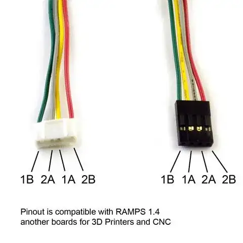

For the sake of completeness, but at the risk of going off-topic, the connector to the printer controller board is often a DuPont, and not a JST, particularly in, but not limited to, Arduino (Atmel/AVR based) boards.
From the same website, this page Stepper cable for RAMPS pinout, shows the DuPont connector to the control board and the JST-PH-6P connector to the stepper motor (I've not fixed the typos in the quoted text):
This pinout information will help you to use our 1 meter stepper cables correctly. Cable was made to be compatible with 6-pin JST connectors on NEMA 17 stepper on one side and RAMPS board connector (also called dupont connector) on other side. Main feature of RAMPS stepper header and this cable is that you can reverse stepper direction by turning connector on RAMPS 180 degree.
This cable is aslo compatible with CNC V3 shields for Arduino UNO and other electronic boards for 3D Printers and CNC control. Please observe the following piut diagram to make sure that your particular electronic board is compatible.
Female DuPont connectors for the control board (4 pin) and JST for
the stepper motors (6 pin PH)

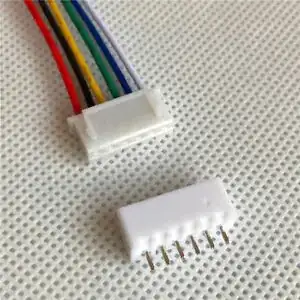

Maybe It is most likely not... JST XH 2.54 6 pin female
and the reverse side, showing the locking, with the male PCB connector
JST XH 2.54 6 pin female - reverse side with locking mechanism
