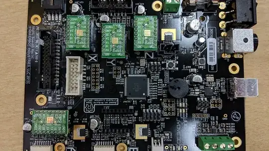

Makerbot appear to use the Mightyboard for the Replicator. INterestingly from the following two photos it would appear that a CH340(G) is not used, and the IC is in fact a 16U2.
Here is a photo of the board (image from MakerBot Replicator 2/2X Rev H Mightyboard – Official, OEM Board w/ 4 BotSteps):
Photo of Mightboard
The IC closest to the USB-B port would appear to be a 16U2:

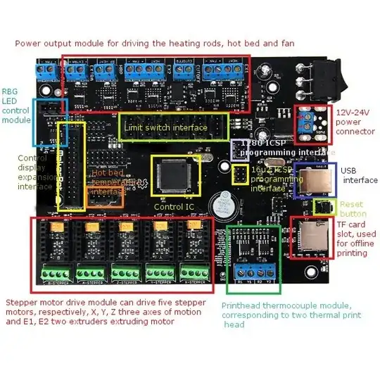

This image (from MightyBoard Motherboard 3D Printer Dashboard), also suggests the a 16U2 is used:
Annotated photo of MightBoard
All of which means that, if your printer(s) have this board, then your Mac should indeed connect to the printer.
