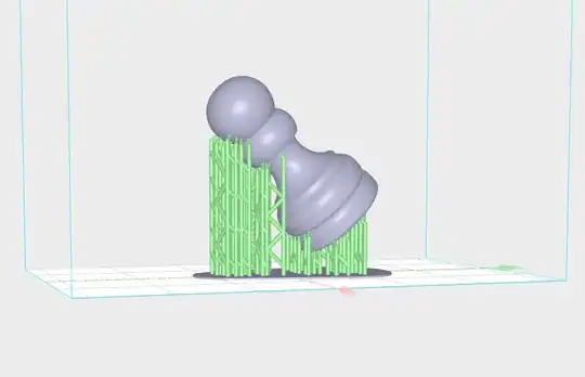

I'm trying to slice some models using the default HALOT BOX software from Creality, which comes with the Halot One resin 3D printer.
I've oriented them at 45 degrees, and am using supports. When I come to slice the models, the models all jump up a few millimetres, as seen in the below screenshot.

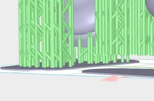

I thought it was just a UI bug, until the same image also appears on the printer screen, with a gap between the supports and the raft.

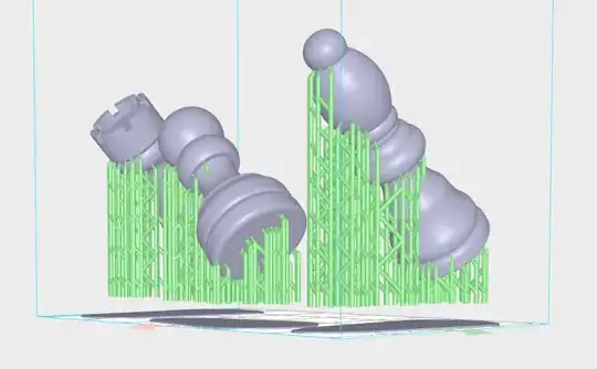

Floating models
If I reset the position of the model, it goes back down as I would expect it to be, but when I click "slice" it moves back up again.
One object back in place

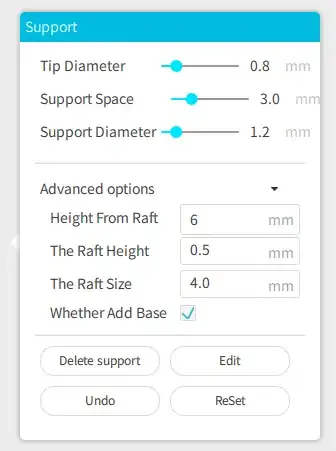

My settings are as follows:
Slicer settings

Turns out I was using an old (and buggy) version of the software.
The version I was using came on the supplied USB memory stick and was version 1.9-something.
I downloaded the latest version (2.0-something) off the Creality website and now it doesn't appear to have the same problem.
Yay!
