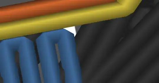

I'm printing small detail on Prusa Mini with Prusament PLA @ default 215 °C.
Model was sliced with the PrusaSlicer with default 0.15 mm quality profile.
The problem is that when the printer is making the bridging infill it does not stick it properly to the perimeter layer. Making the place where head turned back hanging.
What may be the issue and how to prevent it?
problematic tool patch

In my experience, the ends of bridges must always be supported by the layer below them — not the perimeter of the same layer. Add a feature to your model which makes the area under the end of the bridge solid, not a gap.
