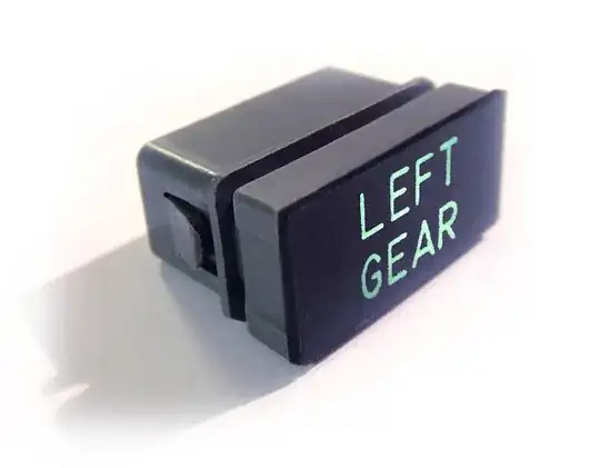

Annunciator removed from a panel where it is separated
I'd like to create an MX keycap with this ability and size with the backlighting changing from green to red to indicate something is on or off. I understand including the MX connector in the center, but how would I print a black panel and leave the text transparent, or at least transluscent?
