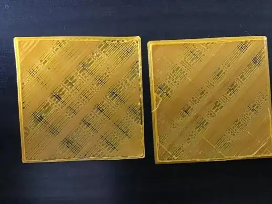

I've had my Ender 3 Pro for a few months, and it's been working great. Then, after a failed print (the STL had extra seams, causing the print to get mangled), I've started having issues that I have attributed to under-extrusion.
As evidenced by the below image, some lines in each layer are missing. The gaps align throughout the print, but not between prints (the two squares are identical G-code). This happens in every layer, with a different pattern in each. It also causes some perimeters to not adhere to the previous layer at all.
The extra strands in the right print are present because I ripped off the infill layer that printed on top before I aborted the print.
I first assumed I needed to calibrate my extruder. It turns out I did (93 had to be changed to 150 steps/mm). However, that did not fix the issue.

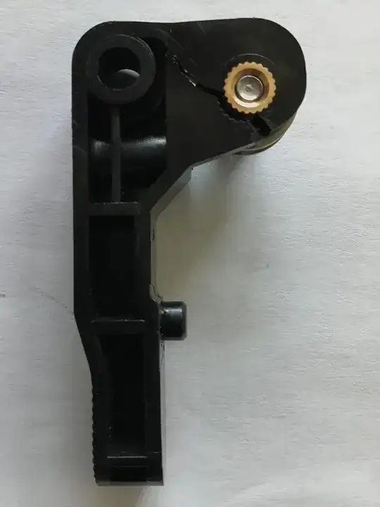

It turns out the extruder was slipping, but not due to a nozzle or Bowden tube pressure issue. The extruder arm (?) that holds the passive wheel (as opposed to the drive gear) was cracked, so the pressure between the wheel and the gear was weak. A bit of glue fixed it.
These printers should ship with metal extruders, I think.
EDIT
The arm broke again, and this time I have a picture to illustrate the issue. I didn't make the printer do anything strenuous; I just printed a few small parts, causing it to break. enter image description here

This is a big red flag and severely wrong:
It can be reasonable to tune steps per mm by a few percent, but needing an increase of more than 50% versus the standard value for the same physical gearing indicates either you did something wrong in computing the needed value, or some other serious root problem with the printer.
You should start by fixing that (putting it back at 93) then try to figure out why it seemed to need change.
Likely your extruder isn't gripping the filament. Trying to overextrude that severely likely grinds it so bad the hob fills up with shavings then doesn't grip at all.
