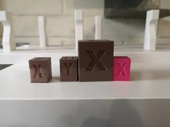

This “worked”, but after that upgrade, I had severe print problems. (See the photos below) These are supposed to be 20x20x20 calibration cubes (the big one is 200%). They are significantly taller than they should be. It may be hard to see in the photo, but this is because the Z spacing on the bottom layers seems to be too high. But, at the same point on each print (even the bigger one), the problem seems to just stop - and layer spacing is correct again for the end of the print.
Comparison of multiple calibration cubes
I tried everything to figure out what this was and I was convinced it was a physical problem with my Z-axis. I read lots of questions on here but nothing quite on topic. I printed on different parts of the bed and got the same result. I re-calibrated my Z steps, but these turned out to be pretty much at the firmware default anyway. I tightened every bolt and eccentric nut I could find that related to the X-axis gantry, but nothing made any difference. Same problem, every time.

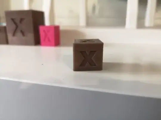

Out of desperation, I eventually switched to the official Creality firmware for the Ender 3 Pro 4.2.7 board with BLTouch - and the problem was fixed:
Printed calibration cube after firmware change
Does anyone have any ideas about what caused this? Have I overlooked something obvious? I’d ideally like to go back to the TH3D firmware but it’s seemingly not an option.

Looking at your prints, the problem is possibly related to the fade out height of the BLTouch functionality.
If you look closely at the 20x20x20 mm cube:
  • half the print is fine (top half of the original correct cube)
  • the bottom "half" (not really half as it is stretched) is porous (grey, indicating more space allowed than the correct layer height per layer should be).
If you look closely at the 40x40x40 mm cube:
  • the first "quart" of the 40x40x40 mm is also incorrect (also stretched),
  • the rest, 3/4 of the top of the print is fine (correct layer height).
Your configuration_backend.h config file doesn't look strange, so the underlying problem could well be more complicated.
A possibility is that there is no reference found to the DEFAULT_LEVELING_FADE_HEIGHT in the linked firmware file. A more in depth answer on enabling/setting the fade height is found here.
M420 S1  ; Enable compensation using current grid/mesh
M420 Z10 ; Gradually reduce compensation until Z=10
It is good to have a fade out height, if zero, the imperfections of the bottom travel all the way to the top of the print; the solution is to use bed geometry (M420 S1) and fade out over 10 mm (M420 Z10).
