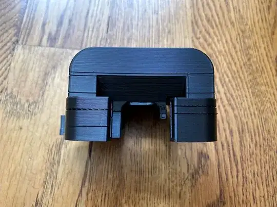

I am having some issues with my printer skipping/not extruding random layers of my prints. It happens a few layers in and sometimes doesn't even affect the entire layer. I have tried switching from Cura to PrusaSlicer but the problem persists. My printer is an Ender 3 v2 with dual Z-axis screws, a Micro Swiss all-metal hotend, Micro Swiss direct drive extruder, and a firmware update to reach 275 °C.
I am currently using Polymaker PC-ABS in an enclosure but I have had the same problem with Hatchbox PETG.
I have heard that Z Hop could be the issue when using Cura. I have tried turning it off while using Cura but it did not solve the problem. I have not tried turning it off in PrusaSlicer.
