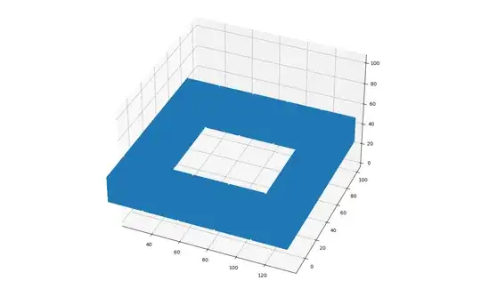

We've been doing some work automatically generating STL files using Python. We've made a ring of cubes like so:
Python generated ring of cubes

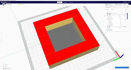

Importing it into Cura still makes it look valid, with a hole in the center:
Ring of cubes in Cura

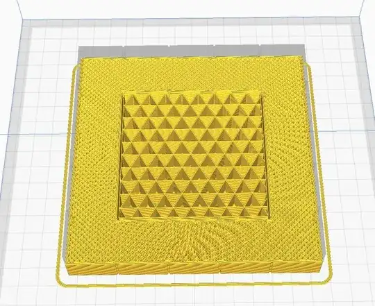

However, post slicing it comes up with saying it will take 14 hours to print! A ludicrous time. Looking at the preview, it seems to be adding supports to the entire inside of the structure:
Slicing preview

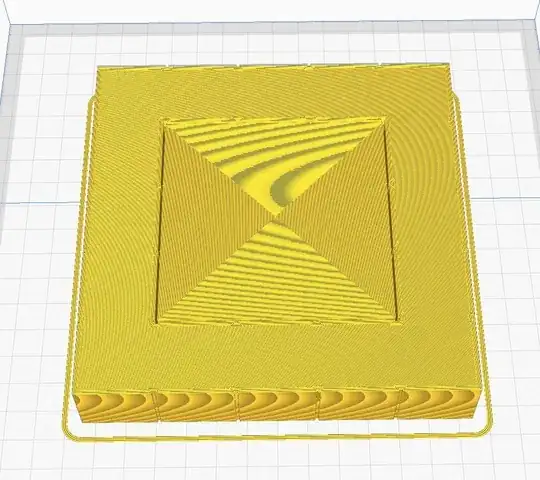

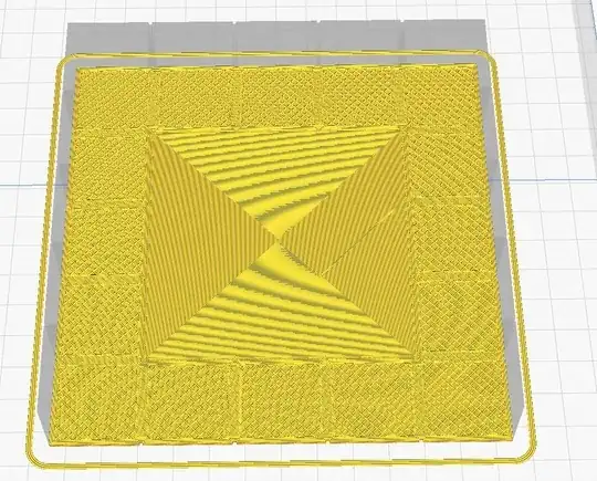

And also a top / bottom layer:
Slicing preview - top
Slicing preview - bottom

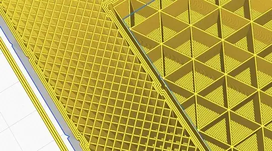

Why is this? You can tell it's adding supports to the center and is not filled in due to the differing structure midway through the block:
Close up of support structures midway

The surfaces are clearly ill defined - it shows the top surface as a bottom one (those are marked red), and so the normals of that surface are pointing to the wrong direction.
