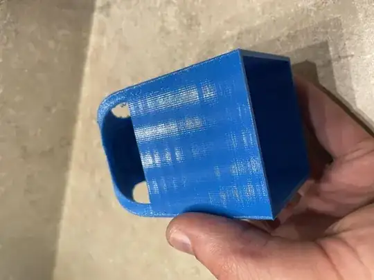

During printing, I’ve noticed a type of “salmon skin” effect going on. It seemed like those areas suffered the worst delamination.
I’ve also noticed on some larger prints, that the consistency of the outermost perimeter is rather non-uniform at certain layers. What I mean by non-uniform is that it seems like the type of “banding” is going on.

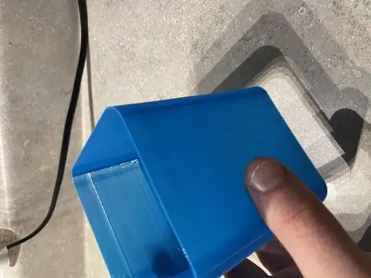

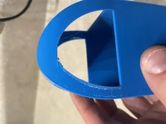

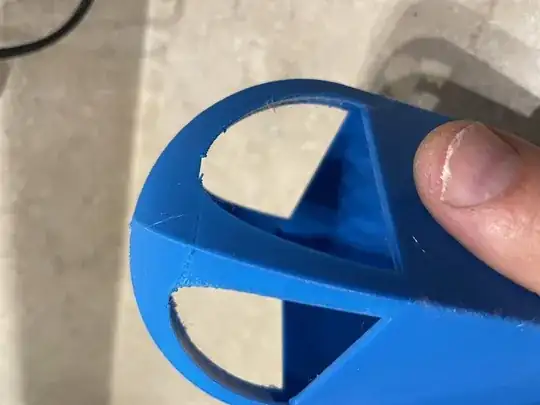

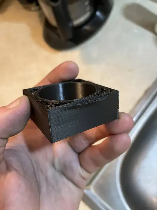

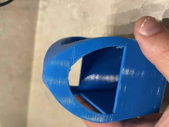

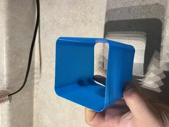

Here are some links to the pictures of a print I just started to test if I fixed the issue, unfortunately, I have not.
Example of delamination in printed part 1
Example of delamination in printed part 2
Example of delamination in printed part 3
As you can see in the pictures, it was delaminating. Unfortunately, it was just from some gentle pressure I applied with the edge of my fingernail.

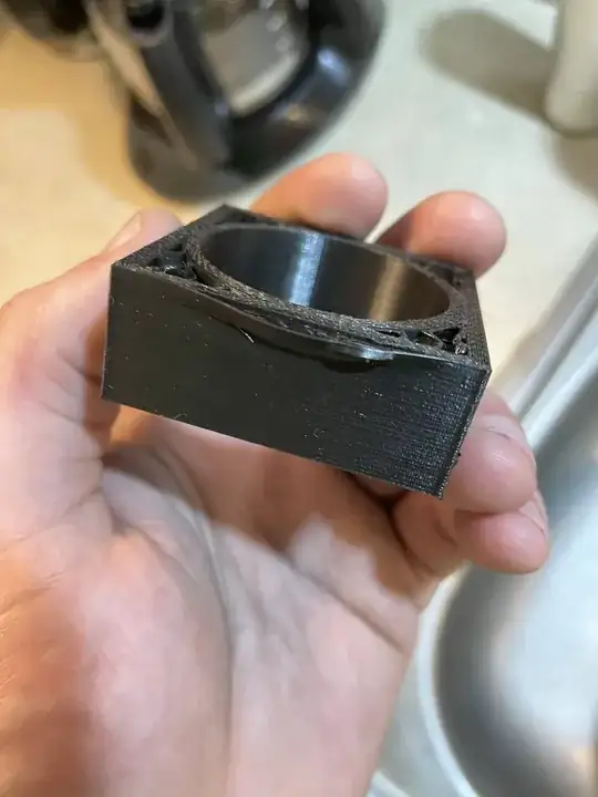

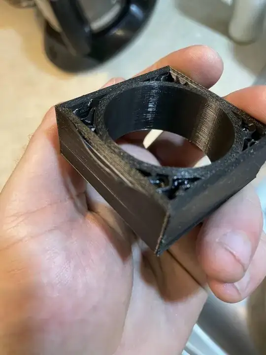

Edit: 6/23/2021- So after a test print, for some reason the perimeters I have not delaminated, at least yet, but I have found other oddities that I have not seen before. Do you have any suggestions?
