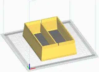

I've been trying to print a Bean Hopper Extension for Melitta Barista TS Smart coffee machine, but every time the layers separate, usually at or near a corner.

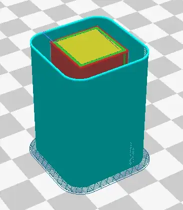

My first attempt had it lifting from the bed before a few layers had completed. When I tried it with a thin brim on the outside, it stuck down for a while, but eventually started lifting away from the bed. When I tried it with a raft, it got further, but then the print detached itself from the raft at one corner. My final attempt used a wider brim on both inside and outside, and it managed to get even further through the print. None of the brim had detached from the bed, but then I noticed layers higher up pulling apart, and when I eventually cancelled the print, I saw it had started separating earlier and managed to recover in later layers.
At this point I gave up and printed it in PLA, first time, but I would like to understand what I can do to improve my chances of printing this next time.
Also, I plan to redesign this with the outer wall extending straight up to the level of the bottom of the notch, with a flat top in which I intend to add a channel for a rubber seal. Will widening of part of the model cause more problems for an ABS print, or will it help strengthen it and prevent it separating as before?
