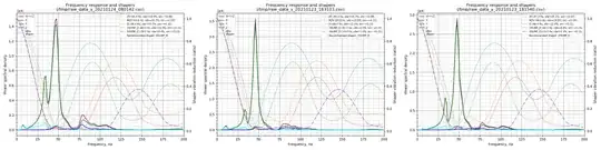

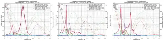

I paste some of the findings:
I took several measurements with different configurations and the results are quite surprising IMO. The following graphs show the respective vibration results for (from left to right):
1- The retrofit back to the standard hard rubber feet
2- The printer only standing on the "feet clamps" as shown in the picture above
3- The printer standing on the "feet clamps" but with squash balls inserted
X-Axis
Configuration 2 vs 3: The damping is causing an additional spike at ~76 Hz; Power-Spectral-Density is roughly the same; Overall vibration is a bit lower in the damped version (11.4 % vs 16% @ 3hump_ei) --> Probably due to damping the additional spike; A bit surprisingly the shaper recommendation is identical
Configuration 1 (original feet) drives Power-Spectral-Density from e3 range to e4 range
Configuration 1 brought back a dominant spike at around 75 Hz to 80 Hz (which was surprisingly gone with the printer sitting on the hard and small area of the "feet clamps"
Configuration 1 nearly tripled the spike at 75 Hz to 80 Hz compared to No. 3 (Power-Spectral-Density 12,000 vs 4,200) The spike at around 30 Hz stayed pretty much the same
Y-Axis
The effect on the Y-axis is pretty small
My conclusions
The resonance effects very much depend on the type of feet
For whatever reason every damping in the feet resulted in worse vibration
If you want to know more about it, install Klipper and an ADXL345 accelerometer, make measurements, write a blog post or post here in a new answer.
