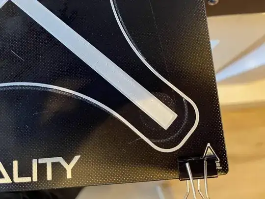

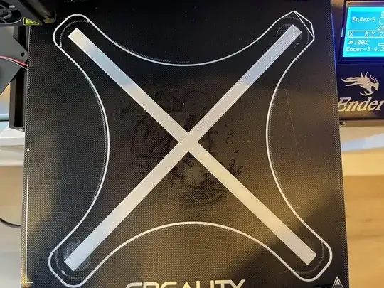

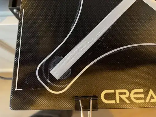

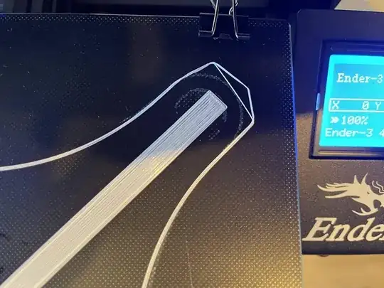

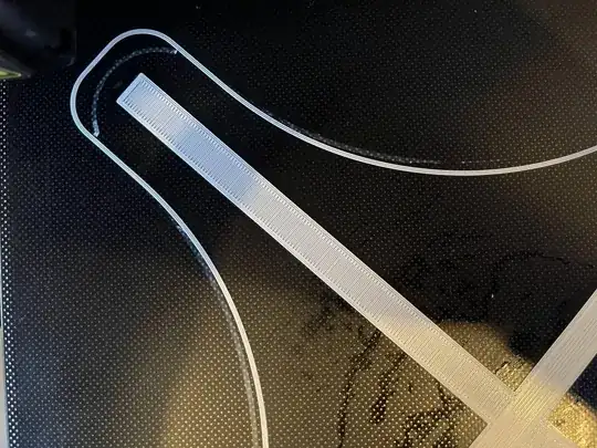

Problem
Despite starting with G28 & G29 in my G-code file, and the printer & BLTouch doing a proper bed levelling (the BLTouch seems to work as intended), the first layer comes out uneven. Please find some pictures below of a test print (this one). I hope the pictures show clearly that the nozzle is too close in the bottom left, and too far in the top right (top left is also a bit far, and bottom right a bit close).
I've done days of research, all over the web, Reddit, forums & YouTube and tried numerous fixes, to no avail
total top left top right bottom left bottom right

Jasper Schulte
  • 141
Had similar problems. I even did a 10x10 grid just to find out that my printing bed wasn't actually flat.
It actually had dips in it.
I would have to look up the command, but I actually just lowered the nozzle by 0.050 mm at a time. Eventually it got too low, and then I backed it off in even smaller increments.
I also had to print with a raft so any extreme dips are held together on top of the raft.

I had the exact same issue as you and had done all the fixes you mentioned. The only thing that solved it for me was to make sure the model in the slicing software was flat to the "bed".
I use Cura and it has a "flat the bed" option which I only discovered due to a model that was slightly off which caused the top and bottom layer to half.
