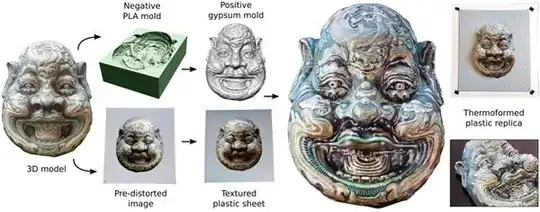

You really can't. That said the only group that has this kind of tech is .. Disney of all companies. That said their tech is good at simple shapes. Nothing more.
I have seen some hydro transfer techniques. However that will not let you position a graphic as it is all done with a stretch transfer material ontop of a water bed. No one has a hand steady enough.
Realistically you either need a high end full color powered base 3d printer, or simple designs that you can apply with you hand, or paint by hand.
Well. Rereading your question... If you just want readable text. Then use a 2+ nozzle printer and print in colors that are contract. IE white model and black text. A lot more work but an order of magnitude cheaper than other options.
Disney article
