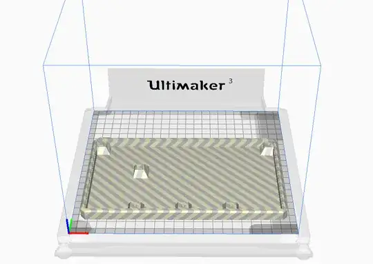

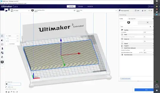

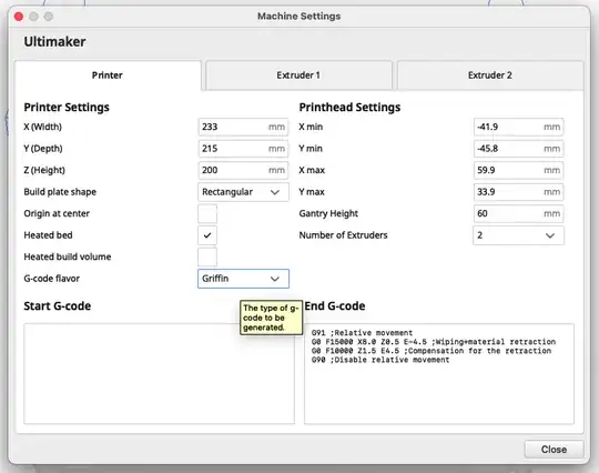

I have designed a model with the dimensions 215x125x12 mm. According to my printer settings, the printing area of the Ultimaker 3 is 233x215x200 mm. But I can not get the model to fit. Why is that?
Here are some screenshots:

Yes that happens! It finds its source in various possible reasons.
  • The print bed is not square! There are cutouts caused by the print head;
  • The Ultimaker 3 has 2 nozzles, when you have 2 active, the effective print bed is smaller than with 1 nozzle active;
  • Using a brim or a skirt also makes the effective print area smaller.

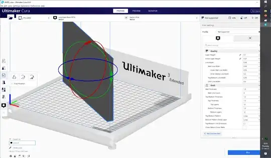

In re-creating your example, the settings in your projects are not correct (but even if done properly, you will not be able to print it flat on the bed). Take a look at the image below, as can be seen your example still has a brim/skirt reservation, be sure to disable the second extruder (as shown by a cross X before "Generic PLA" at the top).
The only solution to print this on this machine is to print it upright:
