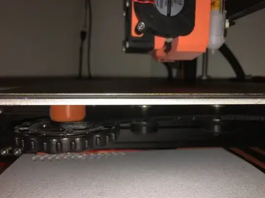

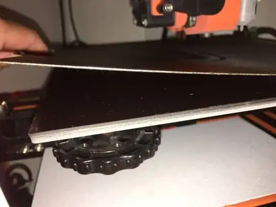

This is my setup on a ender3pro:
three layered setup removable steel spring sheet
