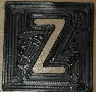

Hello everybody, I want to print something for my family but the hotend gets clogged every time in the same part of the print. I tried:
  • Different Nozzles
  • Different Filaments
  • I cleaned every Part
  • The E-Steps are set right
  • The retraction Setting didn't make a difference
  • The Extruder Position is perfect
  • I tried different speeds
  • Everything else you find on Google with a clogged hot end.
The most odd thing about this is that the problem occurs at the same place every time.
On Flat surfaces are some anomalies, that wasn't there when I had the normal clogged nozzle problems (from: retraction settings, dirty Printer, e-steps false). I think it has something to do with the anomalies.

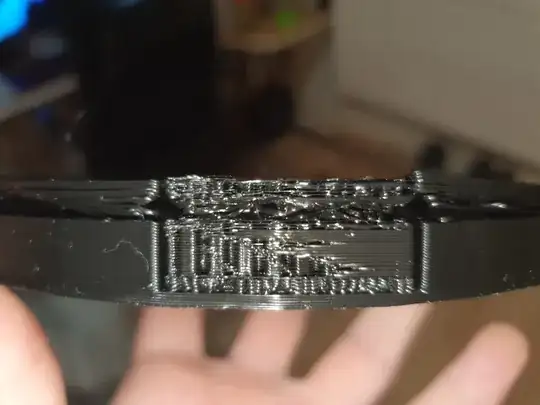

Another thing I don't get behind are missing layers after the layer change, even when I don't use retraction at all. In The Picture from the side you see the Support with the Layer change problem. After around about Layer 40 there is one Layer missing and the next Layers are not connected anymore. From the top you see the Surface anomaly I don't know how to describe. It would be helpful to know what I did wrong. I am sure I did Everything against a clogged Nozzel but I can be Wrong so tips in this direction are Helpful too. I am quite new to 3D Printing(2 Months) I had the usual clogged Nozzel Problem Solved and It Worked Perfectly. I Tried to Fix It with the same Solutions and Nothing Helped, so I think it is a different problem. Sry for my bad English I am from Germany.enter image description here

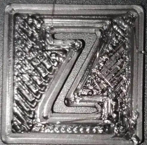

This was made at 200 °C, The problematic areas are at the corners and on Flat Surfaces parallel to the heat bed:
This was made with 200 °C, The problematic areas are at the corners and on Flat Surfaces parallel to the Heat bed.

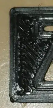

So I tried every Setting in Cura that could have something to do with that, the only thing that helped a little was using 50% Top Surface Flow:
enter image description here this Picture is with 50 % Top Surface Flow
