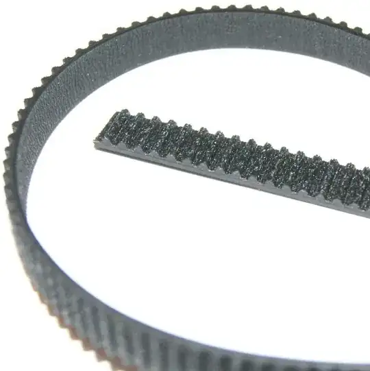

My Prusa Mini arrived with a defective X axis belt. I can order a replacement and it is covered by warranty. But I would also like to know its specifications. This information is available on the store page for the MK3 but not the Mini.

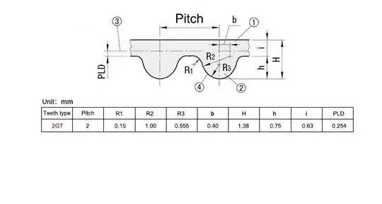

To be sure you could measure the width and the tooth spacing (pitch). The most probable and used belt in 3D printers is the GT2 6 mm belt. The teeth are spaced 2 mm and the width is 6 mm.
