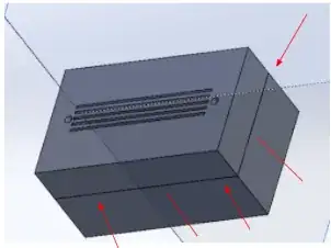

I would like to create a case or a box which has two holes for incoming and exiting water. I want the box to be opened and closed. Therefore it is good to be something like a treasure box.
Is there a way to design the lid of the box to prevent water from leaking around the areas where the box and the lid are meeting without using glue?
