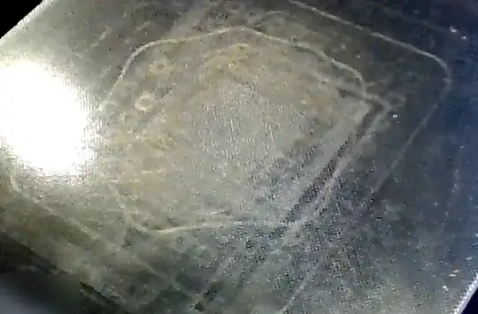

There is filament residue on my glass bed that is so thin that it wont come off. I have had residue buildup for over a year now and none of it has come off. This residue appears with both the PETG and the PLA filament I have. Is there anyway to remove this residue?
Filament residue on bed

I would try a single edge razor blade at a low angle used as a scraper. If you can't feel the blade catching in the residue, it probably isn't an issue.
If you must get rid of it you don't have good choices of solvents. Maybe you can burn it off by placing the class in an oven through a clean cycle. With luck the hearing and cooling won't break the glass.
If you can't scrape it off with a sharp razor blade, I would just let it be.

I had exactly the same issue. I read where ethyl acetate would work so I bought a can of Klean Strip M.E.K Substitute (MSDS says it is ethyl acetate) at Home Depot and it works like a champ. No heating of the bed is required. All of the PLA build-up came off with a cloth rag and a little bit of elbow grease. Make sure to follow instructions. Good luck.

Heat the bed to around 90 °C and then scrape everything off with a metallic scraper, like the ones used to fill gaps in walls. No need of a super sharp one, since the plastic will be very soft a that temperature.
If you have a razor blade and a proper handle to avoid cutting yourself, you won't need to heat the bed to more than 40 °C, since you dont want the plastic to be too soft.

Maybe you could put your bed at the max temperature and print a large square of 1 mm onto it using a higher than normal temperature for that filament, maybe this bonds the residue to the new print. Let it cool down and pry the print off or remove while hot.
