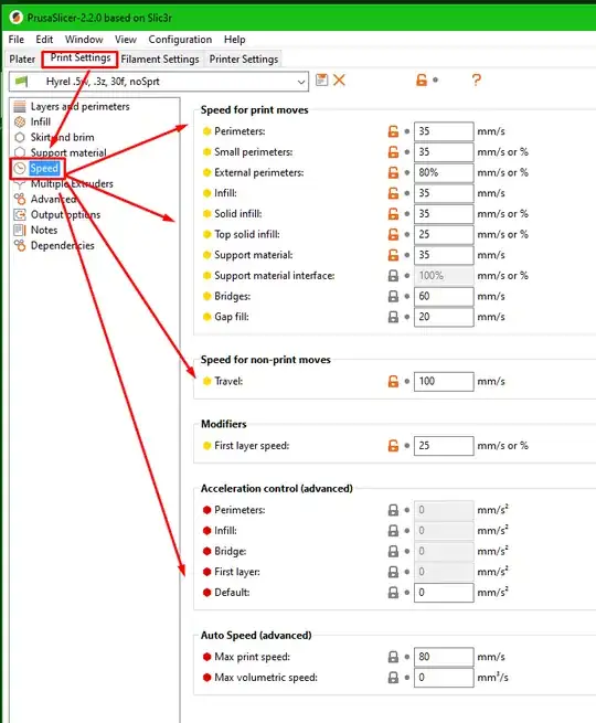

Here's where you change the speed in Prusa:
Changing Speed in Prusa
As Trish said, you're likely trying to push too much material through too fast.
