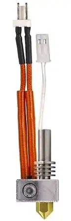

I'm not really sure what the type of plug on the heater cable is. Is it a Molex KK or maybe a JST PH?
The printer is a Prusa I3 Hephestos (aka BQ Hephestos). It came with this "BQ HOT-END HEATCORE CLASSIC" hotend from the "BQ Witbox 1" extruder.
Hotend in question

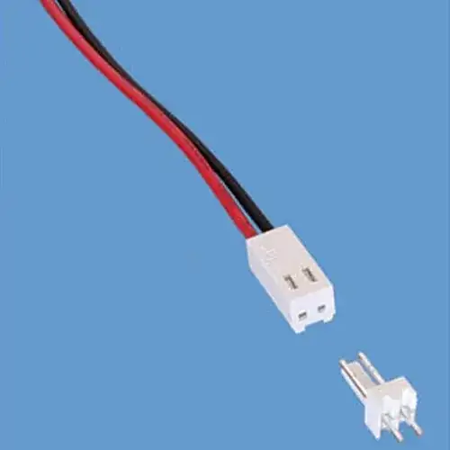

The connector however looks at first glance suspiciously like this one: enter image description here
I found this product on several warehouses, listed as 2-PIN CONNECTOR W/HEADER, .10", and even found a specsheet. Those products appear, in design, to be based on the Molex KK 254 from the 2659 series. A genuine Molex 2659-series connector is rated for up to 2.5 Ampere, and looks somewhat similar.

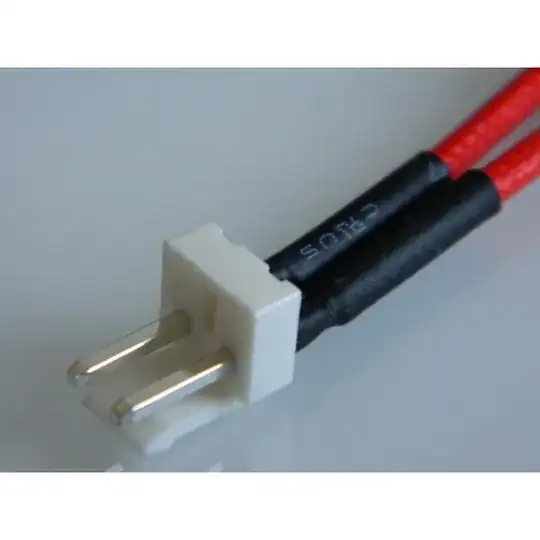

However, the shop did claim it is a JST 2.5 mm pin, and they give a side view:

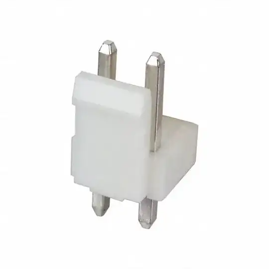

That is not a Molex KK. It appears more similar to a JST NV, which however has a 5 mm distance between the peg centers (= pitch) and it's rated for 10 A (or 120 W at 12V!). While matching in style it does not match in measurements - as OP confirmed, there's a very close to a 4 mm pitch (+- measurement tollerance) on the connector. So it's not an NV, but something os similar style.
But then it has to be the VH! The VH series has a 3.98 mm pitch, it has that latch and it is rated 10 A, for 120 W at 12 V. In fact, the pins on the Hotend seem to be B2P-VH, matching VHR-2N or VHR-2M "female" adapters.
