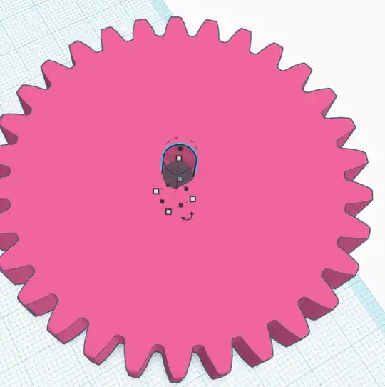

I am currently trying to print a gear with the possibility to connect it to the shaft of a DC motor. The following picture best describes what the shaft of the motor looks like by showing the hole printed in the gear:
So far this works well for a short amount of time, however since the gear is connected to another gear that is from time to time exerting quite some resistance already after a few revolutions the shaft starts to wear out the material that is holding it and it turns without powering the gear, i.e. the printed part is not strong enough to withstand the torque of the motor.

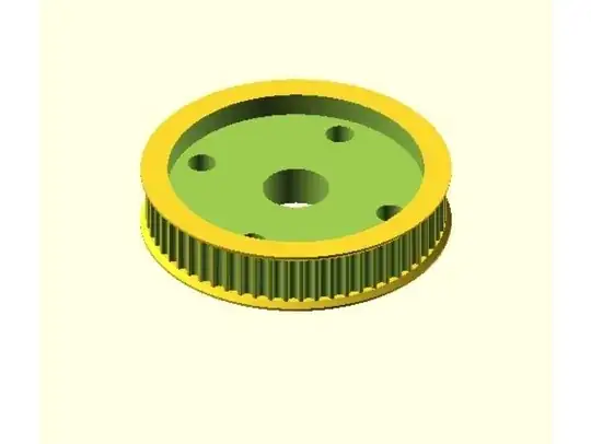

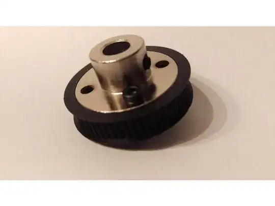

Design a different connection to the shaft, however I don't know of any
Use a shaft/flange coupler to be fastened to your shaft and to your printed part.
Without knowing the length of the shaft, you could connect a flange/coupler to design this into your gear. This is a good solution if you have to transmit larger torques. See e.g. this pulley that incorporates that concept.

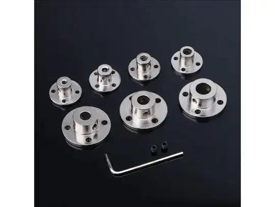

Shaft flange couplers can be connected to your printed part and to the flat part of the shaft.
Metal flange couplers are available in many sizes:
A recess in the printed part houses the flange:
When assembled you can mount the pulley/gear onto the shaft, provided you have enough length on the shaft.

That said, the contact area shown in your drawing is rather small. You'd be much better off using a metal flange to spread the contact out over a larger area.
