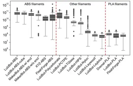

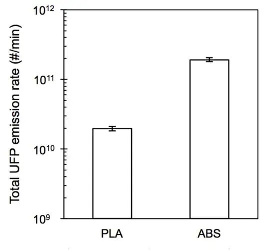

Lot of these have some scary looking graphs. Note that I am being a bit sarcastic when I say "scary looking graphs" the take away is ABS has twice the Fine Partical emission as PLA. However should you be worried, is still up to debate. The idea is that FPE can maybe contribute to cancer or other illnesses. FPEs are thought to irritate the lungs.
These graphs are of the ultra fine particle emissions.
as you can see PLA is MUCH safer in this regard.
