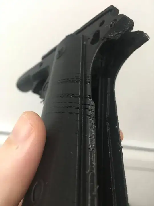

I have been testing my brain for the last few weeks trying to solve this problem: Under extrusion Some info:

  • Printed from USB Stick.
  • E-Steps calibrated
  • Flow calibrated
  • Bed warped(low in the center) but with manual mesh bed leveling calibrated until my BLTouch arrives.
At first I assumed it was related to linear advance, however, decreasing it did help it reintroduced bulging corners. Then I noticed the geared extruder clicking(only sounded like vibrations caused by fast print speeds) during the Linear Advance retractions/deretractions. I then tried significantly lowering the max extruder feedrate/acceleration/jerk (jerk wasn't actually listed in the M503 but I still tried sending the G-code to change it) in firmware, which did stop the clicking (skipped steps?) but not the under extrusion. Also im curious what the "Jerk Contol" settings in Cura actually do since I'm using junction deviation and if I should be using the lower values(0.02-0.1) that junction deviation calls for over the higher(5-30) ones that classic jerk does.

  • Seam: Expose seam(seemed to have the largest effect overall (but only on the calibration cubes,the reciever seen above also has the expose seem option enabled see:https://imgur.com/gallery/dRjptkp)
  • Using PrusaSlicer(Couldnt establish any worthwile comparisons as something unrelated was causing major issues and my MK3 is currently out of order, see:https://imgur.com/gallery/WxJs2Qk)
Im fairly certain it is a Cura specific setting causing this and not any physical failure,however I have tried so many troubleshooting solutions with little to no progress so at this time I am welcoming any suggestions(even if already listed above).
