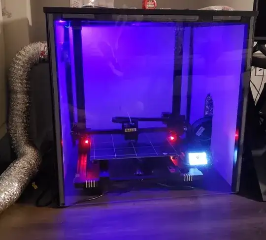

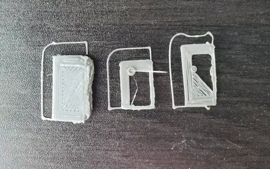

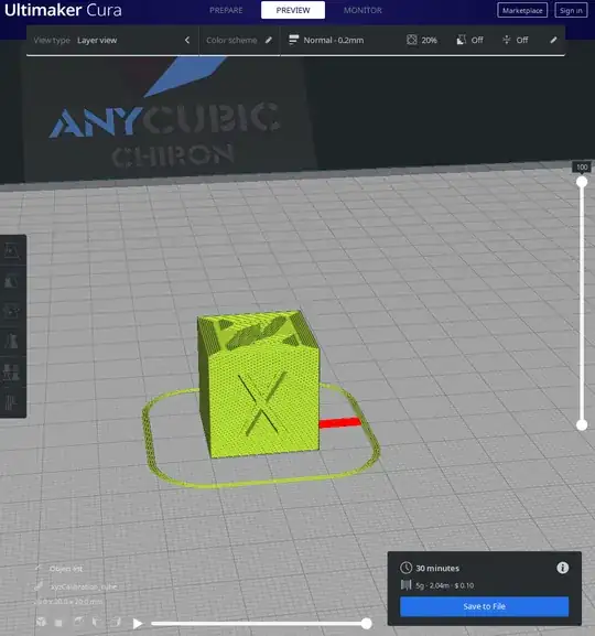

Just took delivery of a massive Anycubic Chiron to my house and have been trying to get it printing successfully for supplies for fellow clinic staff. For some reason, it is only printing a portion of the test shape that Cura is putting out. I am using 1.75 mm ABS Filament, with an enclosure and proper adhesion. Attached is the preview image from Cura. The next pic shows what the printer is actually laying down, some sort of rectangular crop of the test cube and skirt. I just stop the print when I see it repeat the issue.
Cura Preview Printer Output Printer

It looks like either the mechanical travel is constrained or, possibly you have the origin of the X-Y plane in the wrong place in Cura. Usually Cura won't even slice if it thinks the object extends past the printable area, so check the display in Cura "Layer View."
If that's OK, then try using the control panel on your printer to manually drive the print head all the way in both X and Y axes. If it doesn't then the commenters are correct thatyou have a mechanical interference somewhere. If it does, then somewhere between Cura and your printer the "soft limit" of maximum excursion is set wrong. I'm not familiar with your printer model, but there should be a control panel command to "zero all axes," and typically the origin is the front left corner of the build plate (facing the printer, so "Stage Right" in theatre coordinates) .
