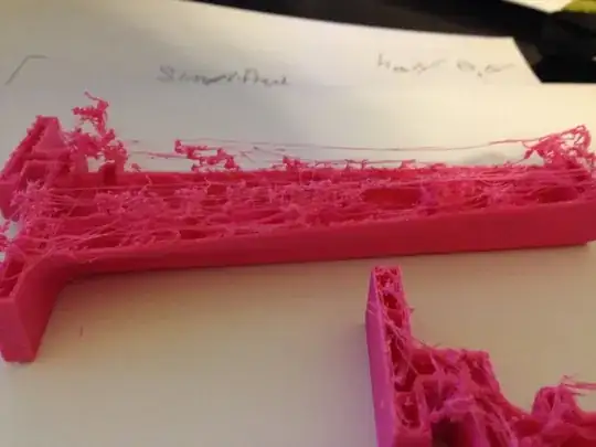

Quick Question. My Printer is the CTC clone of the Makerbot Replicator Dual.
For my past few prints after nth layer the print just starts to go stringy. Here is an example:
Stringy Print

If anybody has any ideas please let me know.
Thank You
  • Does the issue appear after the printer has "changed action", such as started to print an area that require very frequent retraction? Also, does this happen only for one or several different models? – Tormod Haugene May 24 '16 at 11:58
I don't know what was the object like in your plans but it looks like your extruder stopped pushing filament well. I had similar effect when I used extensive retraction with low quality filament. In fact filament was to soft and when it was pressed to hobbed pulley/bolt it became flatened and then stopped flowing. So if your case is similar you could check the following:
  • spring tenssion
  • knurls
  • filament diameter
It's also worth to check if hobbed pulley is screwed tight on motor shaft.
[edit]
It could be also caused by too fast retraction if knurls are not sharp enough they can slide on or scrap filament.
When you notice that again, stop printing proces, lose springs and pull out filament from hotend and inspect its shape.
darth pixel
