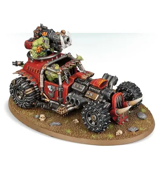

I'd like to prefix this question with the fact that I know virtually nothing about 3D printers, aside from the general principles of how they work.
I've recently seen that SLS printers have become more affordable, to the point where in a few years they might be a compelling investment. I'm mainly interested in 3D printing miniatures for painting, and as such this one:
Warhammer 40k Kustom Boosta-Blasta
For scale, the miniature is about 150 mm long. I'm mainly worried about smaller details, such as the faces of the Gunner or Driver. Will a consumer-grade SLS printer be able to print to such level of detail?

While there are no "consumer level" SLS printers on the market currently, the question in itself is very interesting on a scientific level. The pricing edges for the consumer market for 3D printers can be somewhat estimated from the consumer electronics segment. This puts a maximum price tag of about 2000-2500 \$ onto it, comparable to a high-end PC.
CurrentlyFeb. 2020, most SLS machines come with 'inquire for price' or with prices of 5000 \$ or larger price tags, which indicates they are intended for professional or industrial use. Most SLS printers in consumer hands seem to be phased out older systems from second hand. So while there are for sure tries to get SLS more affordable, it is not there yet.

As a rule of thumb, 50 µm seems to be the average nylon spot size, which is very much comparable with resin printers using SLA/mSLA/DLP technology. Details on miniatures are usually in the area of 100-200 µm, so are well achieveable with either.

It's difficult to tell from your photo the level of detail required. A scale reference in the form of a metric ruler would be valuable. If, for example, the metallic eye on the gunner is 2 mm diameter, that would be 40 layers of 50 micron grains, allowing for substantial detail.
Consumer level SLS printers, such as the Sinterit Kit, use fifty micron nylon powder and is subject to some shrinking. This implies one can expect slightly smaller than fifty micron detail to appear.
One of our makerspace members purchased an SLS model from Shapeways. The surface is layer-free and one can see the individual granules under magnification. If you required a level of certainty of this detail, consider that you can create a model containing various levels of detail, then commission Shapeways to create it.
It's certain that they use a production level system, but one can inquire of Shapeways of the size of the powder that is used.
