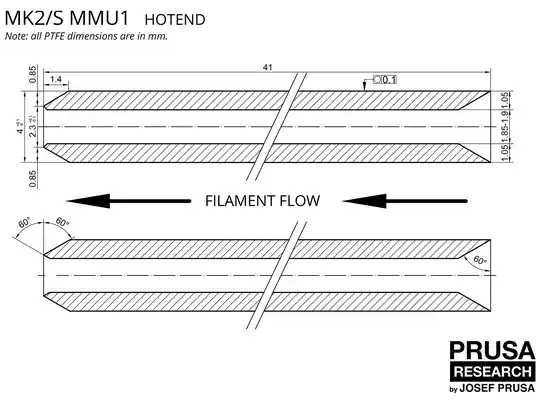

I keep getting a jam where the PTFE tube meets the top of the v6 hot end. I have the PTFE tube all the away in but for some reason it gets a bulge at that spot and will stop printing. It happens with or without retraction. Any ideas?

Filament sometimes get stuck on the rim of the PTFE tubes inside the heat sink. Josef Prusa from Prusa Research has published a document on how you should chamfer the PTFE tubes for his printers:
Josef Prusa PTFE tube chamfering
Maybe chamfering your tubes works for you too.
