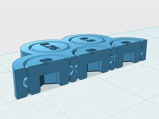

Each printer will have different "print in place" tolerances, but you can find such a model with which to determine the numbers you seek.
One such item is on Thingiverse:
tolerance test model
