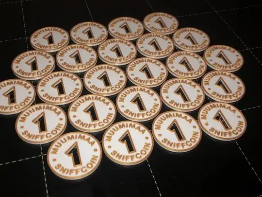

Printed 650 of these tokens, no problem. Then all of a sudden I can't get them to stick and the first layer looks wavy and weird.

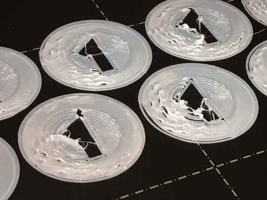

Closeup
After a few tokens it knocks one loose and the whole print fails.
Did try to recalibrate the z-height. Should it be even closer? The test pattern for first layer height looks good.

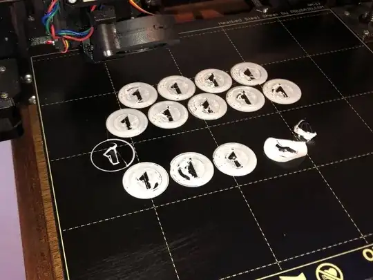

Whole bed

I've been using several different PLA filaments since this started happening. Before, they all stuck to the printing bed like champions, now none of them do. Pictured is som generic white, but getting the same result with Prusament PLA. Nozzle 215°C, Bed 60°C. As I wrote above, I did check the nozzle and it LOOKS fine. It's very small though and I have ordered new nozzles. If no one has any other suggestions I will post more when I have tried the new nozzle.
