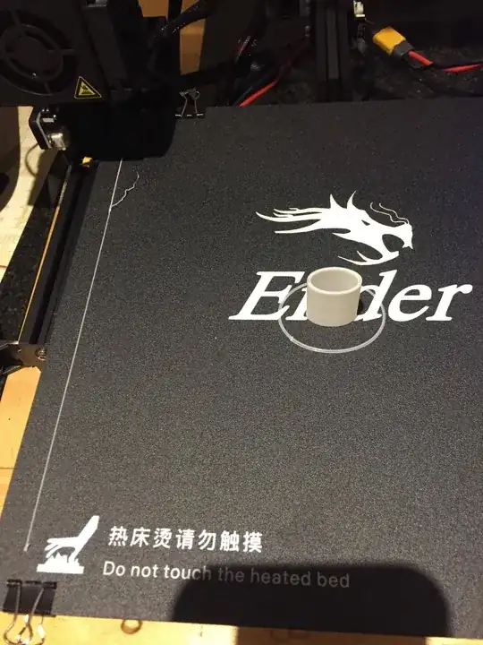

I recently got a Creality Ender-3, and tried printing a few things for some tests. I’ve printed a cube and just printed a cylindrical tube today, and I notice each time, it adds this random line on the left and a sort of outline around the actual print. Neither of these were there in my Cura file, but they’re always printed and I’m not sure why?

Left line = Priming
The straight line on the left is typically used to prime the printer nozzle to get the filament flow starting, this is typically seen in PrusaSlicer (Prusa's fork of Open Source toolpath generator for 3D printers Slic3r). This straight line is called priming line, purge line or intro line, and is typically (but not necessarily) printed outside or at the edge of the bed area. Furthermore, a prime line print routine will catch errant nozzle ooze, test extrusion (it is the first indication if the nozzle to bed distance is correct; if not you can abort with minimal material loss) and perform a final wipe action to avoid stringing between the prime line and start of the print. Note that this straight prime line is not a standard option in a custom profile of Cura, so this was part of the Ender-3 Preset you imported or possibly you have copied a starting G-code that includes this prime line.

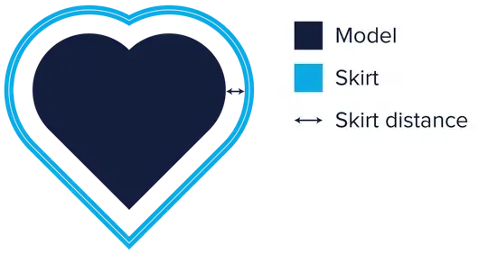

Equidistant line = Skirt
The lines at distance from the print object is called the "skirt", the skirt is an option found under the "Build Plate Adhesion" options in your slicer. The function of the skirt is similar as described for the straight prime line, but it has additional effects that can be wanted. It also shows fairly fast if the bed is unleveled as a whole or if the bed is greasy. Please look into: "What are main differences between rafts, skirts and brims? ".
Note that it is usually superfluous to use both the prime/purge/intro line and the skirt, both have a similar function. The benefit of the skirt is that you can configure it within the slicer (e.g. length of the printed skirt, height to use as a shield for draft or ooze and distance to product). The downside is, that a skirt limits the useable build area by the distance and width of the skirt.

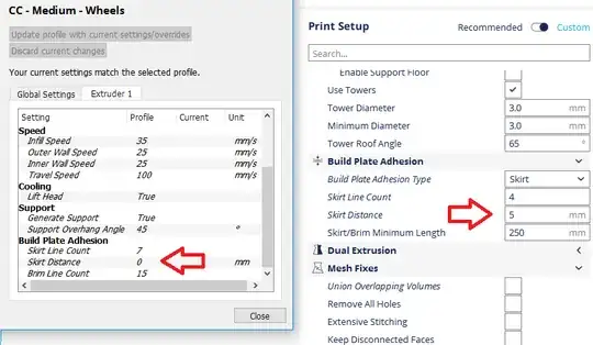

The outline around the actual print is called Skirts. and the random line on the left is called intro line it's not necessary you need both Skirt and intro line. The intro line can disable from custom starting gcode settings
A skirt is an outline that surrounds your part but does not touch the part. The skirt is extruded on the print bed before starting to print your model. Skirts serve a useful purpose because they help prime your extruder and establish a smooth flow of filament. Observing the skirt also allows you to detect and adjust any leveling or adhesion issues before the actual model begins printing.
You can easily edit/disable(not recommended) those settings in Cura (or in any slicing software) In you Cura navigate to Build Plate Adhesion settings
  • Skirt line count: The number of skirt lines printed around the model.
  • Skirt distance: The distance between the model and the skirt.
  • Skirt minimum length: The total length of the skirt. This will override the skirt line count when the minimum length is not reached yet.
