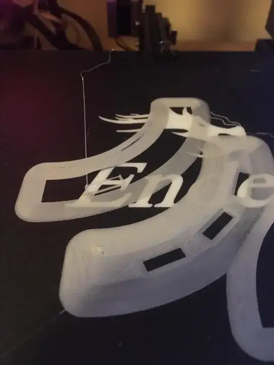

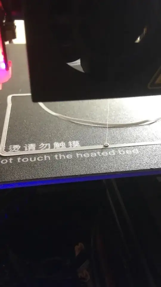

When trying to print wide curves (~4inch radius), later layers of the brim seem to print too close (or over extrude, or otherwise collide) with previous layers, causing the previous layers to detach from the bed. Examples:
(I realise that in these pictures my z-offset looks too small, but I have tried this at a range of z-offsets until the print fails to adhere to the bed at all. The issue persists throughout the whole range of z-offset)
