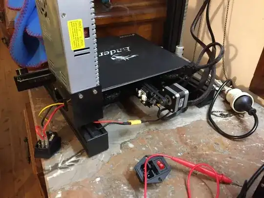

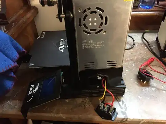

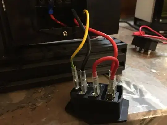

I have a Creality Ender 3, I've had it for just under 2 years and during a print one morning it suddenly stopped and powered itself off. After checking the fuse and other electronic components it still didn't power on. I purchased a new switch as I thought the problem was there but after replacing it is still did not turn on.
The printer has been working fine and there were no visible or audible anomalies. I urgently need this to be fixed.

@trish Thankyou for your help.
I did purchased the new power supply and everything works fine now.
