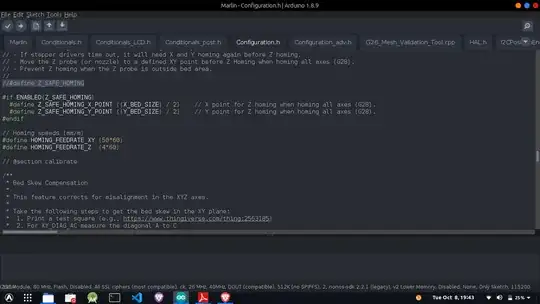

Use Z Safe Homing to avoid homing with a Z probe outside the bed area
According to Marlin firmware with this feature enabled:
  • Allow Z homing only after X and Y homing AND stepper drivers still enabled.
  • If stepper drivers time out, it will need X and Y homing again before Z homing.
  • Move the Z probe (or nozzle) to a defined XY point before Z Homing when homing all axes (G28).
  • Prevent Z homing when the Z probe is outside the bed area.
To Enable Z SAFE HOMING, In the configuration.h file search (Ctrl+F) for #define Z_SAFE_HOMING. By default, it will be disabled to enable it just uncomment the line
